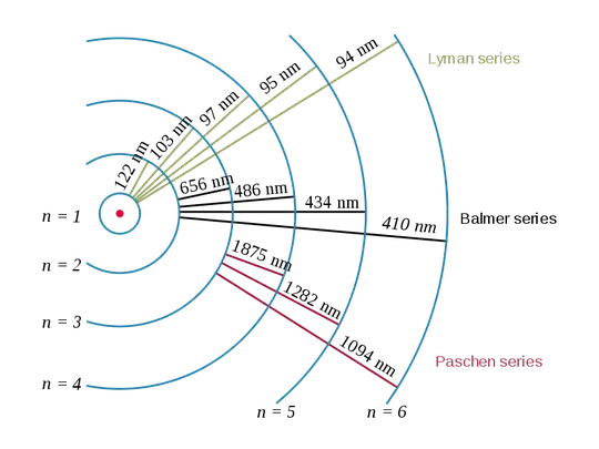

I was wondering if it's possible for a particle to jump from state n to state $n\pm{m}$ with $m>1$ without crossing through every integer state in between. For instance if a hydrogen atom was in state $n=7$ could it get to state $n=1$ in $1$ step or would it necessarily take $6$ steps to get to $n=1$ assuming the that state remains bound at every step?
Yes. See the named hydrogen spectral series:
