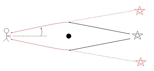

To get an idea why the image formed is a ring, consider the following diagram:
As one can see here, the star behind the lens will appear in "two" separate locations (two dimensions). But in actual three-dimensional space, the star will appear at all points forming a circle: half of it going into, and the other half coming out of, the page (perpendicular to the page). An example can be seen in this image taken by the Hubble telescope:

$^1$ This effect is predicted by general relativity. The equation $$\tag 1\Delta\theta = \frac{4GM}{r c^2}$$ tells us how much massive objects deflect light in terms of the distance of the rays from the optical axis, which leads to the kinds of images we see above.
For a standard convex lens, the further we move from the center $r$, rays parallel to the axis will deflect by a greater angle, and so $$\Delta\theta\propto r$$ or $$\Delta\theta=kr$$ where in the thin lens approximation, the constant $k=\frac{1}{f}$.
But note in equation (1) we now have $r$ in the denominator. For a gravitational lens (like a blackhole), rays of light coming in parallel will not converge at the same points as we move further from the axis (the equation suggests the magnitude of the deflection is inversely proportional to $r$, or the angle decreases for parallel rays further from the center of the axis).
