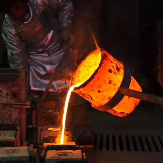

There are nice answers by @rogervadim and @bobd, and I feel like I need to add a nice example why as you say classifying only IR as heat rays is a misnomer.
My favorite example is the glowing hot pieces of metal, emitting a larger spectrum of radiative heat transfer, including IR and visible. The hot metal is trying to reach thermal equilibrium with its environment in every way it can, and this will include emitting visible (other than IR of course) light too. I believe it is as you say a misnomer because in this example you can beautifully see how the object is dissipating heat including visible light, thus classifying only IR as heat rays is not correct. What is correct to say is that because our universe is fundamentally quantum mechanical, the processes involved in heat transfer are based ultimately on QM too (but certainly some can be explained classically), and one of the fundamental reasons QM was "invented", was the UV catastrophe, as you can see from the other answers, the peak of the Planck distribution lies in the IR range, and different wavelength light can interact (be absorbed) involving different QM processes.
But the ultimate answer is that radiative heat transfer can (and sometimes does) include other then IR wavelength light, including visible, so classifying radiative heat transfer exclusively as IR is not correct.
