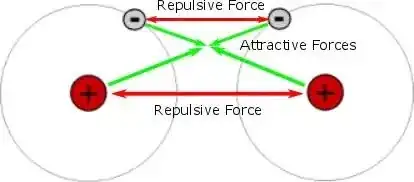

The reason is that there is a force called electromagnetism that prevents atoms and molecules from going through each other.
Whenever you touch something, your hand does not go through because of this force. Upon contact, your hand and the table (let's say) do not pass through each other because the electromagnetic force repels your hand from the table and the table from your hand.
Even though atoms are mostly empty space, the electromagnetic force has a greater influence than the individual particles that make up the atom. The electrons surrounding the atoms of the table interact with the electrons of your hand via the electromagnetic force.
Since electrons have the same charge, and like charges repel, that means your hand cannot go through the table because of this.

A very short answer is "Objects do not move through each other due to electromagnetic forces". Like charges repel, opposite attract. When you bring two atoms close together the electromagnetic force $F=k\frac{q_1q_2}{r^2}$ increase (since we decrease the distance $r$).
