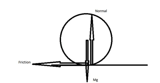

In an ideal case, once rolling starts, friction stops acting as there is no relative motion at the point of contact and the ball keeps on rolling. In a real life scenario, there is some deformation at the point of contact, and the normal shifts slightly and no longer passes through the centre. On performing torque analysis at the centre of mass, you will notice that the force of friction(acting opposite to the velocity of the centre of mass of the ball so as to slow it down), acts to increase the angular velocity of the ball, however, the slightly shifted normal force now provides a torque in a sense opposite to that of the angular velocity, therefore slowing the ball down eventually.
