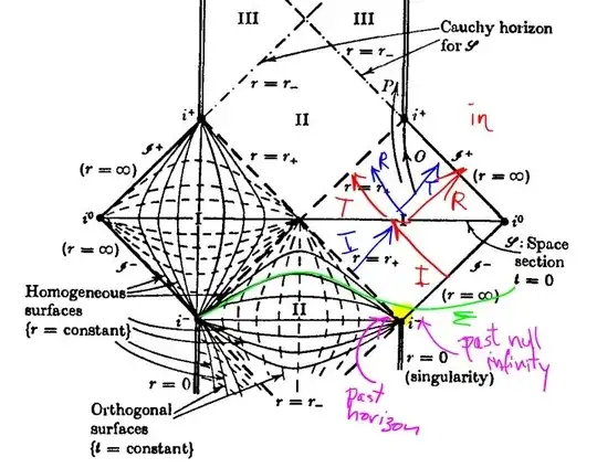

where I know that $d\Sigma^\mu=d\Sigma\;n^\mu$. The statement says that by using a Cauchy surface close to the union of the past event horizon and past null infinity for the in and up modes, we find, as computed in this paper (eq. 16)
$$\mathcal{N}_{\omega\ell}=\frac{1}{\sqrt{4\pi|\omega|}}, \tag{9}\label{9}$$
which seems to be a quick exercise of computation as in the flat KG inner product computed here and here. I dont understand the configuration previous to the computation: a Cauchy surface close to the union of the past event horizon and past null infinity, and how this would lead to \eqref{9}.
EDIT: Use the Penrose diagram:
My reasoning is as follows. In the Penrose diagram for a RN black hole,
penrose_RN_bh
