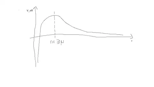

If you sketch $V_{\text{eff}}$, you'll get this
The threshold for the photon to escape is that $\dot{r}=0$ at $r=3\mu$, which tells us $k^2c^2 = h^2/(3(3\mu)^2)$.
