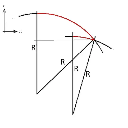

As you know already from @Dale's and my answers to your previous question (How do geodesics explain two identical balls thrown up at the different speeds?), all trajectories in 4-dimensional space-time with gravity $g=10\ \text{m/s}^2$ have the same very big radius of curvature $R=\frac{c^2}{g}$.
So let's draw two trajectories of two bodies with the same curvature radius $R$.
space-time diagram
The bodies are released at different heights ($h_1$ and $h_2$) with zero velocity (i.e. with horizonzal slope). The one starting from higher level is released first, and the one starting from lower level is released at a later time. After some time they meet at the same point in space and time. They need different times of flight ($T_1$ and $T_2$) until they reach this meeting-point. And then they have different velocities (i.e. different slopes in $z$-$ct$ diagram).
You see, there is nothing mysterious about the fact that they reach the same point with different slope.

You need to distinguish between slope and curvature.
Of course different trajectories can have different slopes at the same spot in space-time. Slope is a property of a trajectory, not a property of the spot in space-time. However, all trajectories passing through this spot in space-time share the same 4-dimensional curvature ($1/R$). Therefore it makes sense to say: curvature is a property of space-time itself, instead of a property of the trajectories.
In short, since you drop one after the other, at the moment the second object is dropped, the first object is passing by with some velocity. The two objects have different energy at the same time. In a 2-D analogy (like a North Pole example), it's like approaching the same point from many different angles, where each angle represents a different amount of energy at the same time. And although you can imagine an animation where each walker walks at the same speed in terms of interval per proper time, the physical velocity isn't the velocity you imagine anymore, but rather the angle in r-t space.
