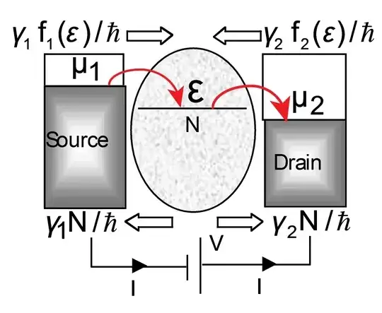

Nevertheless, despite your attempts to compute the conductance of a 1-D wire, there is no reason why the Landauer approach should not work for the system you provided, i.e. a quantum dot. Besides it is pedagogical to start with a simple system (say) with just one discrete level. Say your conductor is a quantum dot with only one discrete energy level coupled to two metallic contacts (source and drain) which have an abundance of electronic states. As shown in the figure below, just like the flow of water, electrons from the source contact (with energy $>\varepsilon$) will jump into the discrete energy level. Then the electron which arrives in this discrete energy level then jumps into the drain contact. I'm sure it must be obvious that you must have $\mu_{1}>\varepsilon>\mu_{2}$ for this to work.
The quantities $\gamma_{1}$ and $\gamma_{2}$ are some interface parameters (with units of energy) which determine the coupling strength of this discrete level to the source and drain contacts respectively. Now, $\gamma_{1/2}/\hbar$ represent the rate at which an electron can hop into/out of the discrete energy level. By dimensional analysis you can convince yourself that $\gamma_{1/2}/\hbar$ is indeed a rate (i.e. units $s^{-1}$). I know this is a bit hand wavy, but $\gamma_{1/2}$ are phenomenological parameters, and can be determined such that they are consistent with our formalism. The quantities $f_{1/2}(\varepsilon)$ are $$f_{1/2}(\varepsilon)=\frac{1}{1+\exp\left({\displaystyle \frac{\varepsilon-\mu_{1/2}}{k_{B}T}}\right)}$$ are the Fermi-Dirac distributions in the source/drain contacts. Now, for $T=0$, we have $f_{1}(\varepsilon) = 1$ and $f_{2}(\varepsilon) = 0$. In other words, since a state in the source contact is always occupied at energy $\varepsilon$, it will jump into the discrete energy level. At the same time, since a state in the drain contact is always empty at energy $\varepsilon$, the electron, which jumped from the source to the discrete energy level, will now jump into the drain. The expression for the current, due to a single discrete energy level, can be written as
\begin{align} I(\varepsilon)&=\frac{2e}{\hbar}\left(\gamma_{1}f_{1}(\varepsilon)-\gamma_{2}f_{2}(\varepsilon)\right)\\ &=\frac{2e}{\hbar}\gamma\left(f_{1}(\varepsilon)-f_{2}(\varepsilon)\right) \end{align}
where in the second line we have assumed the simple case $\gamma_{1}=\gamma_{2}$ (the factor of 2 comes from spin degeneracy). However, if you now had more than one states, like (say) in the 1-D quantum wire, you can find the total current by
\begin{align} I&=\int_{-\infty}^{\infty}d\varepsilon\; I(\varepsilon)D(\varepsilon)\\ &=\frac{2e}{\hbar}\gamma\int_{-\infty}^{\infty}d\varepsilon\;\left(f_{1}(\varepsilon)-f_{2}(\varepsilon)\right)D(\varepsilon) \end{align}

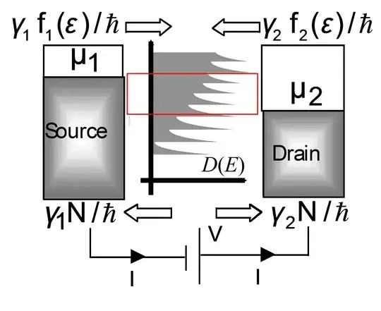

where $D(\varepsilon)$ is the density of states of the 1-D wire. The plot of the density of states has been shown below
It can be noted that only the electronic states in the red box will conduct any current since they satisfy $\mu_{1}>E>\mu_{2}$ (please excuse the fact that I am using $E$ and $\varepsilon$ interchangeably). For a single sub-band the density of states in a 1-D nanowire goes as $D(E)\propto E^{-1/2}$. The above picture shows the density of states for a multi-subband nanowire.The derivations for these can be found in many excellent sources. For example, check section 9.5.3. of this reference.
