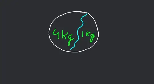

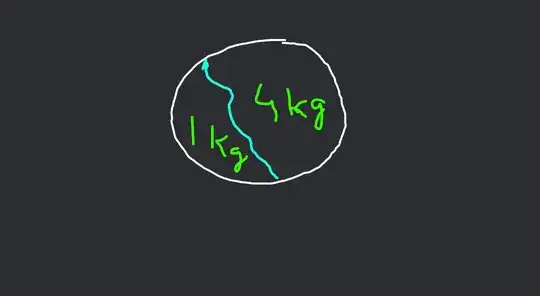

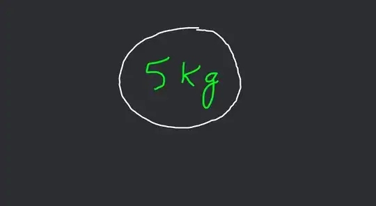

Consider the diagram. Suppose Initially it was a sphere (and I have shown a dashed line in subsequent figures to indicate the points where they separate).
Now in practical experiments, you will get your first set of values if the masses just before the explosion are arranged as shown in the figure
And the second set of values correspond to the situation when the masses are arranged in this way :-
So in practical experiments, which set of values we get depend on the position of the pieces (just before the explosion) inside the main sphere . But it's not random.

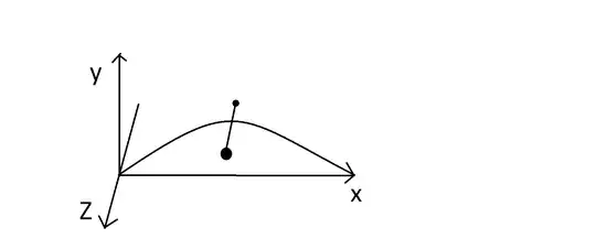

To expand on my comment. Since the question is quite ambiguous there also exist the interesting scenario where the fragments fly off in the z-axis (see picture). I believe that the only reason for the information that the fragments fly "horizontally" is that we do not need to take into account the loss or gain of GPE. But the direction of the horizontal-trajectory is not specified meaning it could be in the x-axis giving two equally valid solutions has you noticed and as Ankit nicely explained. But it could also be in the z-axis note that it would also here be two valid solutions $v_{1}\approx -7\rm ms^{-1}$ or $v_{1}\approx 7\rm ms^{-1}$. And this is the same reason as Ankit explained, it depends on which way the explosion is oriented.
Note also that it could be any arbitrary direction in zx-plane and it would always give two solutions.

Let $y$ be vertical direction, $_i$ denotes just before explosion and $_f$ denotes after:
$m_1=4kg, m_2=1kg, m_{i}=5kg,$
$v_{xi}=5m/s, v_{zi}=0$
For any explosion angle $\theta$:
$v_{1x}= 10 + 5\sin({\theta})$
$v_{1z}= 5\cos(\theta)$
$v_{2x}= 10 - 20\sin(\theta)$
$v_{2z}= -20\cos(\theta)$
$$mv_{tot x}= m_1v_{1x} + m_2v_{2x}=(40+10)+(20\sin\theta-20\sin\theta)=50=m_iv_{xi}$$
$mv_{tot z}= m_1v_{1z} + m_2v_{2z} = 20\cos\theta - 20\cos\theta = 0$
$KE_f=\frac{ [m_1|v_1|^2 + m_2|v_2|^2]} {2}$
$= \frac{m_1 [(10 + 5\sin\theta)^2+ (5\cos\theta)^2] }{2} +\frac{ m_2 [(10 - 20\sin\theta)^2+ (-20\cos\theta)^2] }{2}$
$= \frac{[400+ 100(\sin^2\theta+\cos^2\theta)+ 400\sin\theta]}{2}+ \frac{[100+ 400(1)-400\sin\theta]}{2}$
$=500 = KE_i$
Since this is for all theta $0$ to $2\pi$, at each angle from $0$ to $180^O$ it covers $m_1$ and $m_2$ splitting off both ways.
