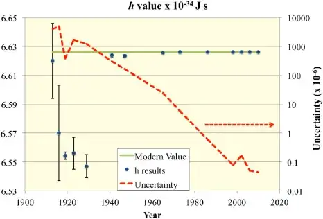

I don't think this is quite what you want but the accepted value of the Planck constant has varied since it was first measured.
This figure
taken from
Steiner R. History and progress on accurate measurements of the Planck constant. Reports on Progress in Physics. 2012 Dec 18;76(1):016101.
shows the evolution of the accepted value as the measurement techniques improved over time. Note that the current accepted value is outside the error bars of an entire cluster of values from measurements done between ~1915 to ~1930. I have not had time to re-read the paper by Steiner but I remember reading at some point (possibly elsewhere) that this cluster was explained in terms of confirmation bias, i.e. nobody dared to publish a result that would disagree too much with the previous results. The current value is now defined to be $6.626 070 15 \times 10^{-34}$ J Hz$^{-1}$ but is not the subject of consensus (section 7 of Steiner).
There is no theory that I'm aware of, similar to other hypotheses, to suggest that the Planck constant would change in time or not have a uniform value.
