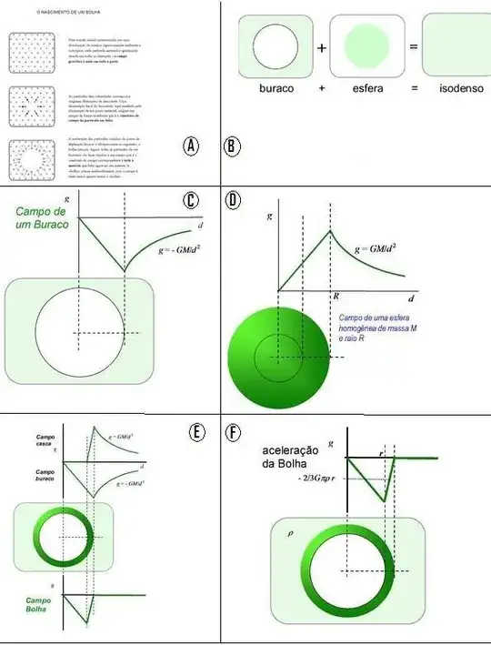

The answer asks for a solution that must encompass a much larger spatial region then the overdense/underdense region of interest. I think that you are aware of the usual answers focused in the overdense situation and I will focus mainly in the underdense case.
The underdense case: in the fig A below we have an intuitive description: in In an isodence world (top image on A) each and all of the particles stay immobile because each particle is equally balanced by forces from the top and from the bottom, from the right and from the left. In the other two small images on A is shown that matter will migrate away of the underdense region (hole). A shell of overdense material will form in the outer region of the hole and that shell will have an accelerated motion to the outside region (equations in the images E and F) making the void larger and larger as time goes by. This phenomenon is the origin of the large voids we see in the universe.
Even if you start with temperature 0ºK in a rarefied gas, as it corresponds to the mean density of the universe, the overall temp will increase as time goes by showing that the 2nd thermodynamic law can not be used under the presence of gravity.
Equations:
Racionale in Fig B and the equations of the acceleration fields in figs C and D: the gradient of the field of an isodense, infinite or large enough region, has a constant null value everywhere, here represented by a uniform green, and is equal to the superposition of the field of a hole (equation of the acceleration represented in the fig C) with the field of a uniform sphere (acceleration represented in fig D). The two equations sum 0 for any $d$ (distance to the centre of the sphere of radius $R$ ).
So, in the figure C is represented the acceleration felt by a test mass in the underdense situation. As it is always negative the force will move the test mass away of the centre. In the fig D is represented the usual situation of an overdense uniform region and the acceleration is always positive forcing any test mass in the outside to be attracted to the centre.
I gave a similar answer in PSE and got downvoted, but I'm used to it. I will specify better the constraints of the problem: The usual $\frac{1}{r^2}$ Newtonian force is used and is good to this problem because we dont need strong fields neither relativistic speeds. Any interaction between masses is not instantaneous at a distance but it is mediated by the speed of light. The argumentation goes as (Ron answer there) 'in an infinite universe in Newtonian gravity the stability is compromised'. Then I say that the masses are present in the universe since a limited amount of time and therefore it is unphysical to mention an infinite universe because the interaction is mediated by the speed of light/gravity and it is sufficient to consider an enough large spherical region around the underdense region. Some years ago I did a computer simulation of this case and I took rightly in consideration a large enough region and saw the migration of the masses to the outside (I remember I've used the principle of superposition to fake an infinite universe).

a tentative translation from portugueese to english of the legends:
O nascimento de uma bolha - The birth of a hole
buraco - hole
esfera - sphere
isodenso - isodense
Campo de um buraco - Field of a hole (gravitational)
Campo da casca - Field of the shell
Campo da bolha - Field of the void
Aceleração da bolha - Acceleration of the void
EDIT ADD :
in a comment It is found: "Isodense matter does not make a null g."
Let's explain. $g$ is an acceleration that shows how a test mass will react in the presence of the field. With a null $g$ the particle do not know where to move neither how fast is the rate of grow of it's velocity.
In a isodense universe there are no features at all, not a single point upon which one can anchor some preferred direction. In contraposition imagine that we can anchor a line at Earth and Sun centres, and we have a clearly defined coordinate. That is the case of a non isodense situation.
Returning to the isodense case. Any plane defined on it has no different properties from any other plane, idem of any line on any plane.
This means that we can choose any line to study the one-dimensional, any plane to ... any 3D boxes with equal length sides are equal one to the others. So let see what happens with the 1D case : define a point, any, as origin (X=0) and mark distances positive and negative in opposite directions. At any absolute distance X, from 0 to the event horizon, (not infinite ok?) we have a contribution of a net force = 0 at the point X=0 : the $dm$ at $X$ will contribute with $F(X)$ and the $dm$ at $-X$ will contribute with $-F(X)$. Provided that the interaction propagates with the same speed in any direction.
Because the result is the same (net force=0) with any choosed origin any integral has always a definite 0 value.
In a more sensible way. If $g$ was different from 0 in the isodense universe, as stated in the comment, then a test particle with 0 initial speed will have to start to move. BUT what direction will it take ? The only solution is the particle has a 'motu proprio'.
