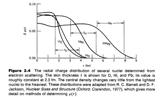

What we know experimentally about nuclei is a charge density distribution reconstructed from electron-nucleus scattering. This doesn't include neutrons [Introductory Nuclear Physics book by K. Krane] Experimental radial charge distributions from Introductory Nuclear Physics book by K. Krane

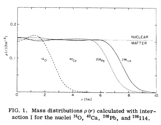

In theoretical calculations one can look at density of both protons and neutrons together [Vauterin, Brink, 10.1103/PhysRevC.5.626] Theoretical calculation of proton + neutron density in nuclei, (Vauterin, Brink, 10.1103/PhysRevC.5.626)
So, nuclei shapes are often close to spheres of constant density with a neutron skin, where density quickly drops. On top of the spherical shape there are various deformations that make certain nuclei more prolate, oblate, or pear-shaped. More exotic shapes are also possible.
