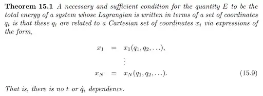

In the same book, chapter 15.1, Theorem 15.1 it says:
Blockquote
So both are conditions that gives the first integral as the Energy of the system.
However i am don't how both conditions are connected to each other. For example how does the system being closed means that we can write the Lagrangian where there is no $t$ or $\dot{q}_i$ dependence between the old and new set of coordinates.
Also in Example 1 given in the chapter 15 of the same book it says:
As mentioned above, the Cartesian coordinate E is always the energy
How is this possible when this doesn't imply that first condition?

  2. In the Lagrangian formulation of classical mechanics, with $N$ point particle positions ${\bf r}_1, \ldots, {\bf r}_N$, in order to define $n$ generalized coordinates $q^1, \ldots, q^n$, we usually for technically reasons assume $3N-n$ holonomic constraints. The definition of holonomic constraints explains why the positions ${\bf r}_i(q,t)$ don't depend on the generalized velocities $\dot{q}^j$.
    Now, if furthermore the positions ${\bf r}_i(q)$ have no explicit time-dependence, then it doesn't matter if we define the Lagrangian energy function $$ \begin{align} h ~:=~&\left(\sum_{j=1}^n\dot{q}^j\frac{\partial}{\partial \dot{q}^j}-1\right) L \cr ~=~&\left(\sum_{j=1}^n\dot{q}^j\sum_{i=1}^N \frac{\partial \dot{\bf r}_i}{\partial \dot{q}^j}\frac{\partial}{\partial \dot{\bf r}_i}-1\right) L\cr ~=~&\left(\sum_{j=1}^n\dot{q}^j\sum_{i=1}^N \frac{\partial {\bf r}_i}{\partial q^j}\frac{\partial}{\partial \dot{\bf r}_i}-1\right) L\cr ~=~&\left(\sum_{i=1}^N \left(\frac{d {\bf r}_i}{d t} - \frac{\partial {\bf r}_i}{\partial t} \right)\frac{\partial}{\partial \dot{\bf r}_i}-1\right) L\cr ~=~&\left(\sum_{i=1}^N \dot{\bf r}_i\frac{\partial}{\partial \dot{\bf r}_i}-1\right) L \end{align} $$ using the generalized coordinates $q^j$ or the original positions ${\bf r}_i$. In the above equation we have repeatedly used the chain rule. See also e.g. this & this related Phys.SE posts. This explains the condition mentioned in the last line of Theorem 15.1.
    By the way, the Lagrangian energy function $h$ is the first integral from the Beltrami identity.
