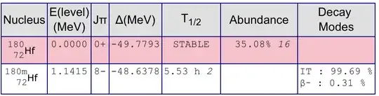

I have been making an excel spreadsheet of all nuclides with half-lifes 20 hours or longer. If you look on the any of Wikipedia's "Isotopes of [insert any found element here]" pages, you will see lists of all the known isotopes for a given element. On some isotopes, you will see more than 1 row for the given isotope. Examples can be found on the Isotopes of Antimony page. Antimony-106, 114, 116, 118, 119, 120, 122, 124, 126, 128, 129, 130, 132, 134, and 136 all have additional rows with an "m" added on to the isotope name. Some, such as 126 and 129 have more than one. At the bottom of the page, I see a note saying that m= "excited nuclear isomers". So, I go to the Wikipedia's page on nuclear isomers.
From what I gather from this page, nuclear isomers are excited atomic nuclei. They can be very short and long lived. But, I am still pretty lost. For example, I can't find anything that says HOW the nucleus gets excited. Then, the page says:
Nuclear isomers have long half-lives because their gamma decay is "forbidden" from the large change in nuclear spin needed to emit a gamma ray.
So, this claims isomers last longer, but that seems to be the case less often than not. All three isomers of antimony-126 and 129 are shorter than the ground state. However this is not always the case as Tin-121m1 has a longer half-life than its ground state.

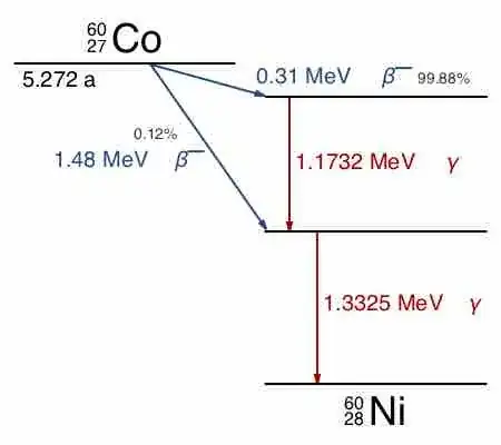

Looking at the cobalt-60 decay energy diagram:
You see there are two channels. Each is beta decay is to a nickel-60 isomer. The $^{60m1}{\rm Ni}$, $^{60m2}{\rm Ni}$ then decay via the electromagnetic interaction ($\gamma$ ray) to the stable ground state, $^{60}{\rm Ni}$
Since energy is released, the mass of $^{60}{\rm Ni}$ ($M=55825.174085\,$MeV) is less than that of $^{60m}{\rm Ni}$ by the energy of the gamma ray.
So looking the two isomers:
$$M_1 = M + 1.3325\,{\rm MeV}=55826.50658499274\,{\rm MeV}$$ $$M_2 = M + 2.5057\,{\rm MeV}=55827.679784992746\,{\rm MeV}$$
While the masses of constituent nucleons is:
$$m_pZ + (A-Z)m_n=56337.711500405436\,{\rm MeV}>M_2$$
The binding energy is the difference, so for Nickel and the 1st isomer:
$$ B_0/A = 8.542290256878186\,{\rm MeV/nucleon}$$ $$ B_1/A = 8.520081923544906\,{\rm MeV/nucleon}$$ $$ B_2/A = 8.500528590211495\,{\rm MeV/nucleon}$$
Thus: the isomer has less binding energy (larger mass) than the ground state. At greater excitation energy, the binding energy falls. When it passes 0 and becomes negative: the nucleons have too much energy and the nucleus is totally unbound. (Of course, in practice, this may happen sooner...by emitting a $\alpha$ particle, for instance, in which case a new nucleus can be formed).

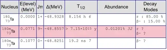

tantalum-180 properties
the decay of tantalum-180m directly$^1$ to its ground state would require the emission of a very soft (77.1 keV) photon carrying away at least $8\hbar$ angular momentum with negative parity: a low-energy M8/E9 transition. Your nuclear physics textbook will have you work problems about why electric quadrupole transitions (E2) are slower than electric dipole transitions (E1) but comparable to magnetic dipole transitions (M1), and the textbook will stop there. We don’t even have a nice name for M8 transitions (“magnetic 256-pole”); they don’t happen at rates we can detect.
(Beware that the notation “tantalum-180m2” is nonstandard: it’s not clear whether “m1” should precede “m2” in mass, or in decay energy, or in lifetime, or in spin, or in historical order of discovery. To unambiguously identify a nuclear state, specify its energy, angular momentum, and parity.)
Decay via weak interactions (beta decay) and strong interactions (alpha emission, proton/neutron emission, fission) are also subject to the general guidance above: the relative energies and angular momenta of the initial and final states influence the rates of the decays. The electron-capture decay of tantalum-180m to the hafnium-180 ground state, in the language of beta decay, would be “seventh-forbidden.”
Interestingly, hafnium-180 has a quasi-mirror state that’s also an isomer. However in hafnium the high-spin configuration of the nucleons isn’t the lowest excited state: the path to the ground state is a cascade of one dipole and four quadrupole photons.
Note that
\begin{align} \rm ^{180m}Hf(8^-) &\to \rm{}^{180m}Ta(9^-) + \beta^- + \bar\nu \\ \rm^{180}Ta(1^+) &\to \rm{}^{180}Hf(0^+) + \beta^+ + \nu \end{align}
are both “allowed Gamow-Teller” beta decays with positive Q-value; both are observed.
$^1$ Actually the Ta-180m isomer is the second excited state, so there is one other photon emission possible: an E7 transition with energy 38 keV, followed by an M1 decay to the ground state. If Ta-180m decay is ever observed, that’ll be the path.
