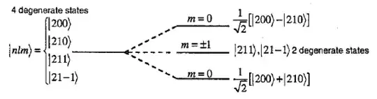

I know the ground state of hydrogen is unaffected by the Stark effect to first order. And I also know that the 1st excited state is split from 4 degenerate states to 2 distinct, and 1 degenerate state like this:
Hydrogen splitting
But I don't quite understand why. I imagine it is something to with (anti)symmetry of the wavefunctions and selection rules.
Can anyone explain?
