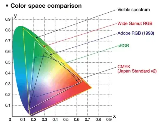

The CIE Chromaticity diagram from that other answer is somewhat informative.
With 3 display colors, you can perform a linear interpolation of them, and you can reach any space within the convex hull of their locations. In other words, if you pick 3 points, you can draw a triangle between them and reach any color in the interior.
There are certainly material reasons that make one specific color easier or more difficult to produce, but in general you can see that the largest triangle you could create within the CIE color space is one with one corner at red, one corner at blue, and one corner in green.
You can cover more space with more points, but that becomes more complex with less marginal benefit. 3 points seems to be a good tradeoff between utility and technical complexity.
See also this SO question enter link description here which shows a representation of a few different color gamuts.
