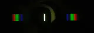

If you attempt to create white light using three "primary" colors, you find the resulting distribution is very different:
Note the lack of continuity between the colors. This light is very different than the white light above. However, to us humans, the colors look the same. This is because we perceive colors using 3 (or 4) different chemically sensitive compounds and then process it in the brain from there. To a mantis shrimp, which processes light very differently and has 12 different chemicals, our "white light" LEDS would look very not-white.

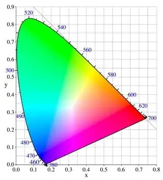

When it comes to humans, we have found a particular model of color valuable, known as CIE. The goal of CIE was to make it so that every color a human "distinguishes" has about the same area on the graph. The CIE graph looks like:
As it turns out, if you mix two colors on this graph, the perceived color is a simple average of the colors you mixed. Thus, if you have 3 pigments to play with, you can generate any color within that triangle. Everything outside of that region is "out of gamut."
From this perspective, for humans, red green and blue create a triangle that covers the most area, so thus can emulate the most colors. However, this only true for human perception. At the physics level, colors just don't mix that way.
