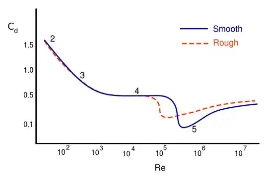

For instance, look at the drag force felt by a sphere as a function of Reynold's number (from wikipedia )
In the low reynold's number limit, drag coefficient scales as $\text{Re}^{-1}$ whereas in the high limit it is roughly constant.
