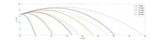

Let's demonstrate this rule of thumb with a simple example. I'll try to simulate throwing a baseball at different speeds, both with and without air resistance taken into account and compare the effect it has on the range the ball travels. For my baseball, I'll use
$$ m = 145 \text{ g} \quad A = \frac{\pi}{4} \left( 9 \text{ in} \right)^2 \quad \rho_{\text{air}} = 1.2 \text{ kg/m}^3 \quad g= 9.8 \text{ m/s}^2 \quad \theta_0 = 20^{\circ} \quad y_0 = 2 \text{ m} \quad C_D = 0.3 $$
Here I show the results of the simulation. The darker lines are with air resistance taken into account, and the lighter lines are without. The colors correspond to different initial speeds.
Simulated Baseballs
And here is a table summarizing the distances travelled with ($L'$) and without ($L$) air resistance, the percent error you would have gotten in the range if you ignored air resistance $\Delta L/L$, and our estimates for the relative importance of air resistance from above.
$$ \begin{array}{c|lllll} v_0 (\text{mph}) & L (\text{ft}) & L' (\text{ft}) & \Delta L/L & \frac{\frac 12 C_d \rho A v_0^2 }{ m g } & \frac{\rho A L}{m} \\ \hline 5 & 4.96 & 4.77 & 0.03 & 0.03 & 0.51 \\ 10 & 11.2 & 10.3 & 0.08 & 0.10 & 1.2 \\ 15 & 18.8 & 16.5 & 0.12 & 0.23 & 1.9 \\ 20 & 28.1 & 23.3 & 0.17 & 0.42 & 2.9 \\ 25 & 38.9 & 30.2 & 0.22 & 0.65 & 4.0 \end{array} $$
So, in particular, notice that when the ratio of the mass of air swept out to the mass of the object is small, air resistance isn't that important. And furthermore, if you actually calculate the ratio of the air resistance force to the other relevant force, this gives you a more accurate measurement of whether air resistance is important, and in particular, if the value is small, it gives you an quantitative estimate of the expected deviation of your answer.
