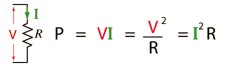

My textbook states that power is transmitted at high voltage and low current since $P=I^2R$ and as the current has a small magnitude, the heat dissipated across the transmission lines is less than when we carry it out at high current and low voltage. But $P=I^2R$ can also be written as $P=V^2/R$ and hence a discrepancy would occur. Where am I going wrong?
Here are the possible ways of writing power
power
Look at how resistance exists in wires. The power is inversely proportional to resistance if one uses the voltage as a criterion, the more resistance in the way the smaller the power transferred for the same voltage. The smaller the current the less power is dissipated by a given resistance on the way and can be transferred where it is needed.
