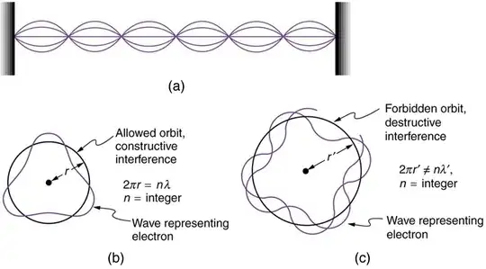

It is said that de Broglie explained the quantization of Bohr's orbitals with the idea of the "matter wave" of the electron being forced to have orbits where it can interfere constructively with itself as a standing wave on a circle.
My question is: what is the reason why the non-constructive orbits would be "forbidden"? Why can't we accept a situation where the wave can travel on the orbit with irregular superpositions or maybe totally destructive interference of the wave?
(Illustration from here)
The Bohr model is tied with quantization of angular momentum by demanding standing waves for the orbit.
There would be no quantization if the wave is not standing. The model is successful in reproducing the spectral series of the Hydrogen atom. That was its success, that the observed quantization of energy could be derived from this assumption, as seen in the link. It is not a matter of "accepting" but of solving with this hypothesis for energy levels and agreeing with data.
