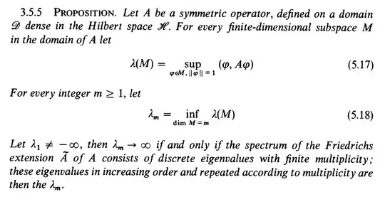

  1. Then we can employ a version of the minimax principle quoted as preposition 3.5.5 from page 64 of David Ruelle's Rigorous Stat. Mech. book. This is a little more general than needed (the Hamiltonian would suffice to be symmetric, but in this case, it is assumed directly self-adjoint).
This proves the fact that the spectral values of the Hamiltonian are increasing. Another proof for the spectral properties of the Hamiltonian would have been from the fact that $e^{-H}$ is completely continuous (from being trace-class), hence its spectrum would also be pure point and decreasing. $e^{H}$ is the inverse of $e^{-H}$, so its spectrum would again be pure point but increasing, and the same goes for the spectrum of $H$.
