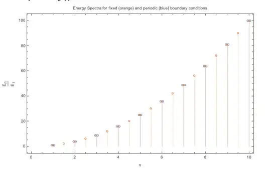

No, as you've directly computed yourself. The spectra of the two Hamiltonians (with fixed and periodic boundary conditions, respectively) are shown here:
The orange circles are for fixed boundary conditions, while the blue circles are for periodic ones. The spacing between the blue energy levels is twice the spacing between the orange ones, but the blue states are doubly degenerate while the orange ones are nondegenerate.
In the limit as $L\rightarrow 0$, the spacing between these energy levels goes to zero, which means that the spectra (and the density of states) become identical. For finite $L$, the density of states for periodic and fixed boundaries are not exactly the same.
