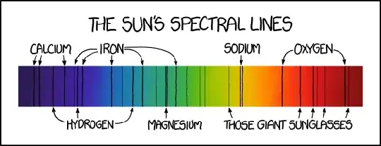

when atoms absorb the photons, they produce the colour complement to the colour of the flame. Similar to how element absorption creates black lines in the spectrum of the sun. The change in spectrum from a single atom will be barely measurable, but it will be there.
Source: XKCD
