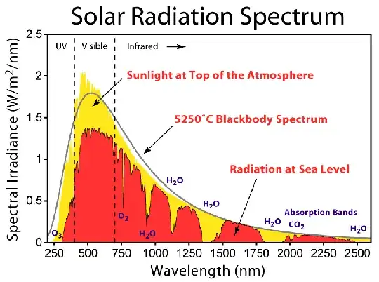

Choice of material matters. One problem with gold is its reflectivity across the spectrum. You want it most reflective at wavelengths the Sun emits more strongly. This is the spectrum.
