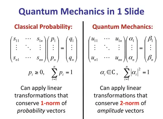

Aaronson then proceeds by arguing that there are only two theories that are "like" probability theory: probability theory itself and quantum mechanics. Probability theory is based on the $1$-norm, whereas quantum mechanics is based on the $2$-norm.
Call $\{v_1,\ldots,v_N\}$ a unit vector in the $p$-norm if $|v_1|^{\ p}+\cdots+|v_N|^{\ p}=1.$
The slide below is from a presentation of his.
Now, it seems that there is yet another candidate out there: the $0$-norm. For this purpose one would have to define $0^0=0$, and, if one does, one has a theory "like" probability theory that is determinism.
