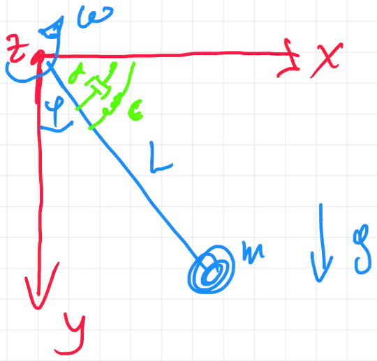

Example: pendulum with spring and damper enter image description here the pendulum is rotating about the z axes with angular velocity $~\omega$
Position Vector:
$$\boldsymbol R=L\,\left[ \begin {array}{c} \sin \left( \omega\,\tau+\varphi \right) \\ -\cos \left( \omega\,\tau+\varphi \right) \\ 0\end {array} \right] $$ external force
$$\boldsymbol f_a=-f_d\,\left[ \begin {array}{c} \,\cos \left( \omega\,\tau+\varphi \right) \\\,\sin \left( \omega\,\tau+ \varphi \right) \\ 0\end {array} \right] $$
where $~f_d~$ is the velocity depending force $~f_d=d\,(\dot{\varphi}+\omega)$
The kinetic and potential energy
$$T=\frac 12\,m{L}^{2} \left(\omega+\dot\varphi \right)^2 \\ U=\frac 12\,\varphi \, \left( \varphi +2\,\omega\,\tau \right) Lc-mgL\cos \left( \varphi +\omega\,\tau \right) $$ $\Rightarrow$
The Hamiltonian
$$H=\frac 12\,m{L}^{2}{\dot\varphi }^{2}-1/2\,m{L}^{2}{\omega}^{2}+1/2\,{\varphi } ^{2}L\,c+\varphi \,L\,c\,\omega\,\tau-m\,g\,L\cos \left( \varphi +\omega\,\tau \right) -\varphi \,L{\it f_d} $$
for $~\omega=0~$ and $~f_d=0~$ the Hamiltonian is equal to the energy $E=T+U\bigg|_{\omega=0}$ which is constant.
