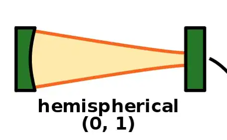

I recently asked this question about the non-axial photons of a laser cavity. While doing further research on the subject, I read that exploiting the paraxial photons by having one mirror of the laser cavity be flat and the other be curved enhances stimulated emission. An example of this seems to be the "hemispherical" cavity geometry in the figure in user A. P. answer:
However, it is also said that this produces a (more) divergent beam.
How is it that such cavity geometries produce a more divergent beam, compared to if we had just two flat mirrors? For instance, if the flat mirror in the image above is less than 100% reflective, and so is the mirror from which the beam escapes the cavity, should it not actually be focused at a smaller point (that is, result in a less divergent beam), rather than a larger point (that is, result in a more divergent beam)? Or is it because, beyond some point, the two rays in the image above "cross over" (I think this is point is called the focal point?), and so the beam actually begins to diverge beyond this point?

Aha. You have one or two misunderstandings. Note that the orange lines are not straight. They are curved near the flat mirror. So what does that mean? What do the orange mirrors represent? The orange lines are perpendicular to the phase front. At the flat mirror the phase front is planar, and the orange lines are perpendicular to the plane of the mirror. If that mirror were partially silvered, the light that gets through would diverge in exactly the same way that it converges inside the cavity.
The field distribution in the cavity is not so simple. It is what's called a Gaussian beam. The profile of a Gaussian beam is displayed in this S.E. post. To make a cavity with a plane mirror the mirror must live where the phase front is planar, the narrow part of the beam, which is called the waist.
For a cavity to be made of two plane mirrors, the phase fronts must be planar everywhere, that is the wave must be a plane wave. A plane wave has zero divergence. It also has infinite cross-section, so the mirrors must be infinite.
Note that a Gaussian beam also has infinite cross-section. However, the field intensity drops off quickly away from the center so that very little light appears at the edge of the mirror. Very little is not zero, so there is always some loss from the cavity.
