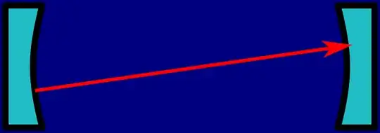

Imagine a ray being tilted with respect to the optical axis.

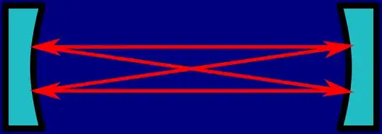

Because the mirrors in a laser cavity are slightly concave the ray gets deflected more towards the middle of the cavity again and therefore doesn't walk off, as it would be the case with two planar mirrors. In the particular example I've chosen, the mirrors form a confocal cavity, i.e. the radii of curvature of the mirrors $R_1$, $R_2$ are equal to the cavity length $L$. Here, one can geometrically show that said ray will travel in a $8$-shaped loop and be identical to itself after 4 reflections:
This holds for any tilt angle as long as the ray still hits the mirror. So there is a whole class of rays which map onto itself after 4 reflections, not just the axial ray. Similarly, you can imagine what happens to a ray being shifted from the optical axis. Analogously, it will also travel in a $8$-shaped loop, irrespective of its exact displacement. For a mathematical proof using the ray tranfer matrix method see for example Kogelnik & Li, Appl. Opt. 5 (1966).

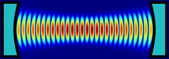

You can also model the situation with waves. Here, the mode formed in the cavity is given by the criterion that the wavefronts of the beam must match the mirror shape, so that the beam is mapped onto itself after a full round trip.

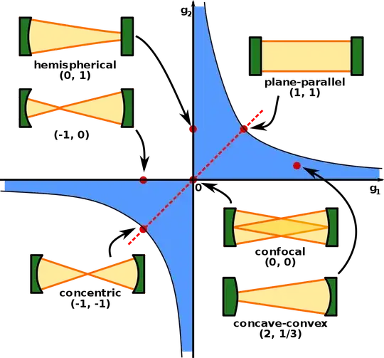

Of course the confocal cavity is just one possible geometry out of many. Which cavities are stable is summarized in the cavity stability diagram. It describes which cavity shapes allow mapping a ray/beam onto itself in terms of geometric parameters $g_1 = 1 - \frac{L}{R_1}$ and $g_2 = 1 - \frac{L}{R_2}$.

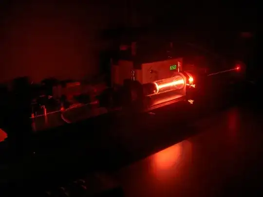

The bright red glow in the glass tube containing a HeNe laser cavity tube shown below is the photons you are asking about, and the answer is that they shoot off and then get absorbed in something. But it's usually but not always a small fraction of the total amount of light produced and
HeNe laser tube glowing with spontaneous emission
