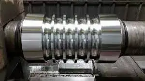

The integral doesn't mean that $x = f(m)$. On the contrary, $dm = f(x)dx$ and only after knowing that function it is possible to solve the integral, with the differential as function of $x$.
A good example for a unidimensional situation is any turned part, as for example a roll for a rolling mill, as shown below. The roll diameter is a function of $x$. So, the mass $dm$ of a small slice of the roll is also a function of $x$.
