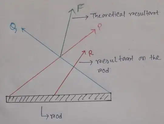

Let us consider a rod and two forces acting on it that are not concurrent, that is, to say that their points of application are not identical, but they intersect somewhere outside the rod. Now, if we theoretically find the direction of the resultant $P$ from the point where both the lines of action of forces are intersecting, will it act in the same direction as the real resultant $R$ (that is, the the force or resultant acting on the rod caused by the two forces as mentioned before)?
Is there any theorem or proof in which this matter is explained? enter image description here
Will the direction and magnitude of $F$ and $R$ be as in the image?

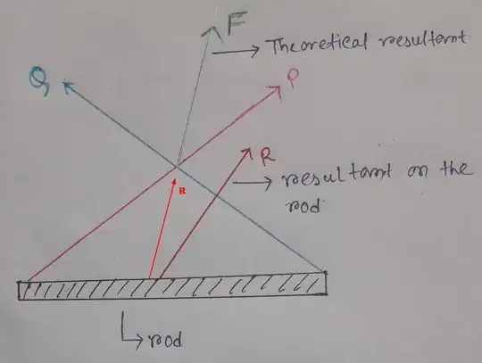

Yes. You can slide any force along its line of action (parallel line through the point of application) and it does not change the system.
In your case $R$ is going to be along the line of action where it intersects the rod. As shown below:
fig1
Note that $F$ and $R$ must have the same magnitude and direction.
