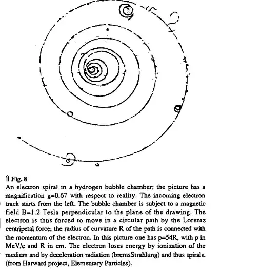

From this article here is an electron crossing a magnetic field perpendicular to it direction, in a bubble chamber.
spiralin electron
In a bubble chamber the electron loses energy also by ionizing the hydrogen, which is why one can see its track,(small bubbles) larger scatters leave the ionization electrons as small spirals. There are two mechanisms of energy loss to create the spiral. Because there is a time interval where the picture of the tracks can be taken, before resetting the chamber for the next events, the spiral seen does not have the time to end at a point.
In this bubble chamber picture , an ionization electron from the beam track is seen to spiral down to a point.
electron
In vacuum, the only energy loss will be radiation, as in the circular colliders , for example LEP, , there is radiation, called synchrotron radiation in the region where there are circular paths for the electron and positron, that have to be compensated to keep the energy constant.
An electron in a circular path in vacuum, in a magnetic field would spiral down to a point, all its kinetic energy going into radiation.
