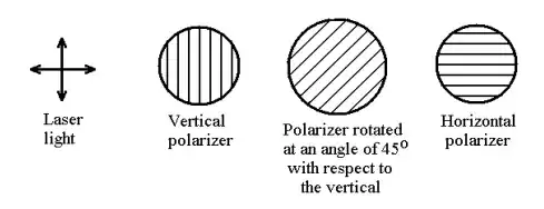

If light is passed through two polarizing filters before arriving at a target, and both of the filters are oriented at 90° to each other, then no light will be received at the target. If a third filter is added between the first two, oriented at a 45° angle (as shown below), light will reach the target.
Why is this the case? As I understand it, a polarized filter does nothing except filter out light--it does not alter the light passing through in any way. If two filters exist that will eliminate all of the light, why does the presence of a third, which should serve only to filter out additional light, actually act to allow light through?
Image of three polarizers, target is at the right

A year later, here is a probabilistic (pseudo QM) explanation.
I am confused by the diagram that appears to show unpolarized laser light - I thought that most lasers by their nature produce polarized light; after the first polarizer that question is moot, so let's start there.
A polarized photon can be thought of as being in a mixture of states - when it approaches a polarizer, it's either parallel or perpendicular (it either passes, or it doesn't). When you polarize a photon and then immediately "test" it with another polarizer at right angles, you know the state it's in: it is "perpendicular" to the second polarizer and will be stopped.
But when you have another angle, you have a certain probability of passing or not passing. In particular, when you're coming in polarized at 45°, there is an equal chance of passing or not passing (it is in a mixture of two states, if you like). So half the photons will pass the second polarizer - and they will come out "rotated".
These photons now hit the third polarizer - again, at 45 degrees. Again, you have a 50-50 chance that such a photon is parallel, and is passed on.
We therefore have a 1 in 4 chance of passing the two polarizers, where before we had none.

Filter 1 allows the component of the light vibrating in the same direction of the grating though. If the angle of the first polarizer is 90 degrees (parallel to the y-axis), then the percent of the photon’s energy passing through will equal the sine of the photon’s angle of vibration (polarization mode). With an equal distribution of polarization modes, that component will average out to 50% of the total energy passing through the first filter, and all of it will have the same 90 degree polarization mode.
With just Filter 3 added, all of the energy is vibrating at 90 degrees has no component along the x-axis.
Adding Filter 2 at 45 degrees results in a percent of the 50% equal to the sine of 45 degrees: (sqrt 2)/2. Passing through another 45 degree filter will reduce it a further (sqrt 2)/2.
Filter 1: 1/2 Filter 2: (sqrt 2)/2 Filter 3: (sqrt 2)/2
Summary: (1/2)•((sqrt 2)/2)•((sqrt 2)/2) = (1/2)•(2/4) = 1/4
25% of the original optical energy will exit Filter 3.
