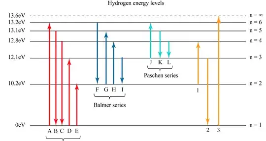

It is important to know that all atoms/molecular cannot absorb all range of light waves(photons) - see here. This is due to the quantization of energy levels (a very Quantum Mechanical Phenomena).
Here is the image of discretion in energy Levels of Hydrogen: Here is the image of discretion in energy Levels of Hydrogen
Hence, very specific photons of the energy equal to the energy difference between the levels are absorbed and then reemitted. All other photons simply passes through. That is the reason why you see lines instead of continuous spectra in the emission/absorption spectrum.
