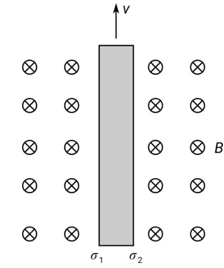

In the above figure, we have a rod moving with some speed in $v$ in a magnetic field $B$, it is said that when at equilibrium the rod generates a surface charge density such that the magnetic field must be cancelled off.
However, I do not understand why this must be the equilibrium state, so this leads to my question, How do you prove that the equilibrium condition for the system is that a charge density is developed on the body of conductor such that the electrostatic force on conductor cancels the magnetic force?

If the magnetic force is not cancelled by the electric force there is no equilibrium, so the charges will move until there is.
