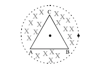

Case 2
Consider case 2 above. Here we have a similar time-varying, uniformly distributed cylindrical magnetic field in the region as shown. An equilateral triangular conductor is placed in the magnetic field, with its centroid coinciding with the centre of the cylindrical region. The three branches of the triangle have the SAME resistances. In this case, we wish to find out the potential difference between the points A and B. This is a very common question given in the text-books.
My question is on this case 2.
In this case, we are asked the potential difference between points A and B.
We know that potential difference is a concept associated with a conservative electric field and not with the non-conservative one. Now in this case, how the conservative electric field will come into existence? The free charges inside the conductor will simply start moving just by the effect of the non-conservative induced electric field and there is no need for us to introduce a conservative electric field in this case like an isolated rod in case 1. And, if there is no conservative electric field then there is no concept of the potential difference!
By this logic, either the question itself is wrong, that it is asking for the potential difference between points A and B, in spite of having no existence of the conservative electric field,
OR I am missing something.
Kindly help me.
How do we understand the idea of potential difference in Case 2?
EDIT1: In the triangular conductor, I have changed the resistances of all the sides to be the same.
But there is a conservative field.
To see this, imagine that the triangle is formed by three resistors (with the same resistance $R$ as per your EDIT 1) and assume the leads of the resistors are formed from ideal wire.
Something like this:
Image credit
There is, due to the changing magnetic flux threading the surface bounded by the resistors, a non-conservative electric field such that the line integral of this field (along the closed path defined by the resistors) is non-zero.
But the electric field within the ideal wire leads must be zero (even when there is a non-zero current through). So, it must be the case that their exists a charge distribution along the wire leads such that that the associated conservative electric field precisely cancels the induced electric field within the wire.
That is, just as in your case 1, the induced electric field separates charge against the resulting conservative electric field. If you think about this a bit, you'll see that this charge distribution along the leads is such that one end of the resistor body is more positive than the other end. Thus, there is a potential difference across the resistor (than can be measured if you're careful with the voltmeter lead placement).
Now can you generalize this to the case that the leads have non-zero resistance?
