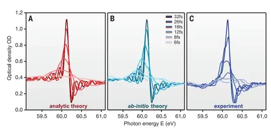

and here is a short glimpse at the results of Kaldun et al.:
As you can see, for short delays the response has a very high bandwidth, and this narrows and resolves into sharper features as the delay increases. The physics is a bit more complicated and interesting than the simple continuum I assumed above (the central frequency $\omega_0$ is chosen to target a Fano resonance caused by an autoionizing state in the system) but the general principles are the same.
