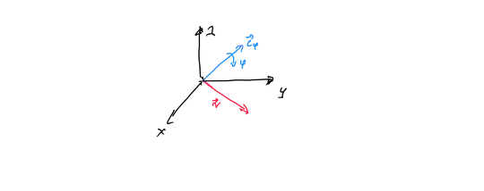

to see where the cross product come from we have to go to 3D space
3D Space enter image description here
The rotation axis is $\vec{\hat e}_\varphi$ and the rotation angle is $~\varphi~$ thus
$$\vec{s}=S({\hat e}_\varphi\,,\varphi)\,\vec{r}$$
where the components of $\vec r~$ are in body fixed coordinate system, and $S~$ is the rotation matrix.
$\Rightarrow$
$$\vec{v}=\vec{\dot s}=\dot{S}({\hat e}_\varphi\,,\varphi)\,\vec{r}\tag 1$$
with: $$\dot{S}=S\,\left[ \begin {array}{ccc} 0&-\omega_{{z}}&\omega_{{y}} \\ \omega_{{z}}&0&-\omega_{{x}}\\ -\omega_{{y}}&\omega_{{x}}&0\end {array} \right] \quad \Rightarrow \vec{\omega }=\hat{e}_{\varphi }\dfrac{d\varphi }{dt}$$
Thus the velocity Eg. (1)
$$\vec v=S\,\left(\vec{\omega}\times \vec r\right) ~,S^T\,\vec v=\vec{\omega}\times \vec r$$
where $S^T\,\vec v~$ are the components of the vector $v$ in body fixed coordinate system
Result
$$\boxed{\vec v=\vec \omega\times \vec r}$$

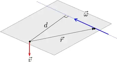

Depending on the definition of $\vec{r}$ you can state the law as
$$ \vec{v} =\vec{r} \times \vec{\omega}$$ where $\vec{r}$ is location of the rotation axis.
The above is entirely analogous to the definition of torque $$ \vec{\tau} = \vec{r} \times \vec{F}$$ where $\vec{r}$ is the location of the force.
Also the above is entirely analogous to the moment of inertia of particle with momentum $\vec{p}$ which is $$ \vec{L} = \vec{r} \times \vec{p} $$ where $\vec{r}$ is the location of the particle.
So what do all the above have in common? All of the above are a "moment of" calculation, with $\text{(moment)} = \vec{r} \times \text{(quantity)}$. There is velocity = moment of rotation, torque = moment of force and angular momentum = moment of momentum.
The significance of $\vec{r}\times$ is to result in the perpendicular distance to a line. Here is a graphical explanation of $\vec{v} = \vec{r} \times \vec{\omega}$
fig
The vector $\vec{v}$ is perpendicular to the rotation axis $\vec{\omega}$ as well as out of plane where the vector $\vec{r}$ lies with $\vec{\omega}$. More importantly, the magnitude of $\vec{v}$ depends on the perpendicular distance $d$ to the rotation axis.
$$ | \vec{v} | = d \,|\vec{\omega}| $$
So you see the $\vec{r}\times$ results in accounting for the perpendicular distance to the axis of rotation.
So the magic of the cross product is that it results in a perpendicular vector with a magnitude proportional to the perpendicular distance. The result is that you can slide the vectors $\vec{\omega}$, $\vec{F}$ and $\vec{p}$ along their line of action, and it will not change the problem, as the perpendicular distance remains the same.
In this sense $\vec{v}$ describes where the axis of rotation is, just as $\vec{\tau}$ describes where the line of action of the force is and $\vec{L}$ describes where the axis of percussion (line of momentum) is. For all these quantities another cross product can recover the point on the line closest to the reference point.
You can verify for yourself that
$$ \vec{r}_\perp = \frac{1}{| \vec{\omega} |^2} ( \vec{\omega} \times \vec{v} ) $$
