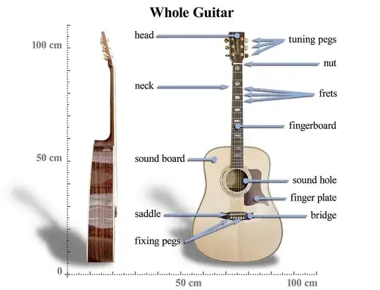

On a guitar, the soundboard is the front of the body. Here's a diagram, courtesy of Wikipedia:
Parts of an acoustic guitar

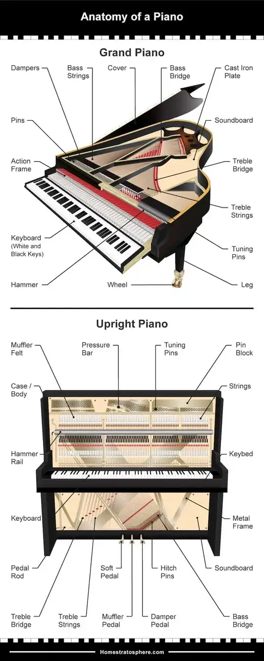

The soundboard of a piano is inside the body:
Parts of a piano
(source)
