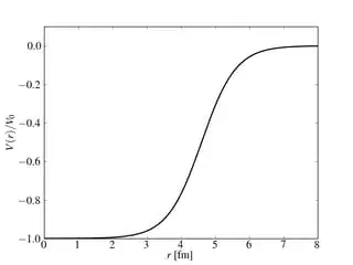

In addition to the link on applications of the harmonic oscillator provided in the comments to your question, note that the finite well has important applications in nuclear physics as the Woods-Saxon potential is reasonably well approximated by a finite square well in 3d. It is then possible to obtain some crude understanding of energy levels splitting with or without angular momentum without resorting to numerical methods: the solution here are in terms of spherical Bessel functions.
