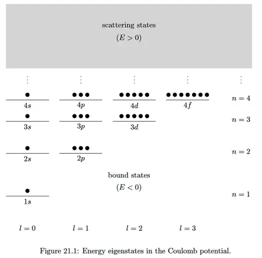

I am reading from Quantum Theory, Groups and Representations - Woit. In Chapter 21, on page 237 in discussion of the energy eigenstates of the Coulomb potential, the following figure is presented:

to be representations of $SO(3)$, given that the Hamiltonian possesses $SO(3)$ invariance. But then when the actual energy eigenstates are presented, we observe the well-known fact that there is additional, accidental degeneracy, due to a hidden symmetry. The symmetry group of the Hamiltonian must actually be larger than just $SO(3)$, with $SO(3)$ being a sub-group. My confusion arises from the following sentence,
If the representation of the larger group is reducible when one restricts to the $SO(3)$ subgroup, giving $n$ copies of the $SO(3)$ representation of spin $l$, that would explain the pattern observed here.

Before Schroedinger published his eponymous equation, Pauli found this QM spectrum and pattern by using this argument. There is a larger symmetry than your angular momentum SO(3), namely SO(4)~SU(2)×SU(2) whose representations are related to n of the spectrum. (For a review see here, or any of the dozens of linked questions above and their links, containing Laplace–Runge–Lenz vector.)
But not all representations of SU(2)×SU(2) enter in the quantization. They have to be of the same dimensionality (and Casimir) for the left and right subgroups. In that case, for the irrep of spin s=0,1/2,1,... we have n= (2s+1), the dimensionality of each spin s. The angular momentum SO(3) is the diagonal subgroup of the above$^\dagger$, so for each energy level characterized by n we have $(2s+1)^2=n^2$ states.
The action of the rotation SO(3) subgroup, then, is the "addition of equal spins" (symmetric Kronecker product of s with s) which is reducible! That means that a representation of SO(4) is a direct sum of representations of its subgroup SO(3); this is the "restriction" alluded to.
For example, writing the dimensionality 2s+1 in boldface, you readily see $$ n=1 \leadsto s=0; \qquad {\mathbf 1}\otimes {\mathbf 1}={\mathbf 1}, ~~~ n^2=1,\\ n=2 \leadsto s=1/2; \qquad {\mathbf 2}\otimes {\mathbf 2}={\mathbf 1}\oplus {\mathbf 3}, ~~~ n^2=4,\\ n=3 \leadsto s=1; \qquad {\mathbf 3}\otimes {\mathbf 3}={\mathbf 1}\oplus {\mathbf 3}\oplus {\mathbf 5}, ~~~ n^2=9,\\ n=4 \leadsto s=3/2; \qquad {\mathbf 4}\otimes {\mathbf 4}={\mathbf 1}\oplus {\mathbf 3}\oplus {\mathbf 5}\oplus {\mathbf 7}, ~~~ n^2=16, $$ etc.
In spectroscopic notation, above, you call $$ {\mathbf 1}\mapsto s; \qquad {\mathbf 3}\mapsto p; \qquad {\mathbf 5}\mapsto d; \qquad {\mathbf 7}\mapsto f, ... $$
Within each n "rung" of the spectrum, SO(3) connects the states of each multiplet in the reduction among themselves, but not to any other multiplet in the reduced sum! To do that, you need one of the other three generators of SO(4) which we did not focus on, but still commute with the hamiltonian, so they bridge to the degenerate relatives multiplets.
