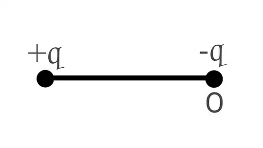

Next dipole moments are independent of origin if the net charge in the system is zero. Consider the system given below:
1.Dipole system

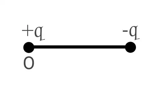

Here we have two charges $+q$ and $-q$ separated by a distance $d$. Net charge in the system is zero. Now if we choose them to be on $X$ axis with the positive charge at the origin. Then the dipole moment of the system is $ -q d \hat{i} $. Obviously this is a vector with direction from the negative to positive charge.
Now if we shift the coordinate system, so that the negative charge is now at origin, then enter image description here the dipole moment is $qd(-\hat{i})$. Again the same result with same direction.

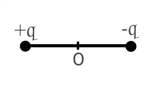

One last case: Origin lies exactly in the middle: enter image description here Here also the dipole moment is $ -q\frac{d}{2}\hat{i} + q\frac{d}{2}(-\hat{i}) = -q d \hat{i}.$ So no matter where you choose your origin you will get the same vector as long as the net charge of the system is zero. If it's not zero then the dipole moment is origin dependent.
And that's why at the elementary level we were taught that the dipole moment is always directed from negative to positive charge.
