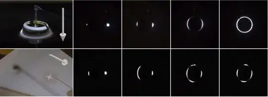

No. It is possible to replicate optical properties of gravitational lenses by a suitably deformed glass of water surfaces.
For example, the paper
uses menisci formed on water surface near drawing pins slightly lifted above the water level to replicate many features of gravitational lensing, including multiple images:
Image from M. Selmke page
