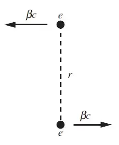

Imagine two protons moving in the opposite directions with a velocity $v$ or $\beta c$, where $\beta = v/c$. At $t = 0$, they are a distance $r$ apart one along the same line (see the picture). I am having troubles deriving the exact relation between electric and magnetic forces (or fields) in this case.

Now, when we move to the problem of oppositely moving charges, the direction of magnetic force is reversed and it will be repulsive, as by reversing the direction of one of the protons, we reverse the direction of created by it magnetic field.
My solution is then the following:
1) We move to the rest frame of the (lets say) bottom proton, which we refer to as first. In its own frame it feels no magnetic force as it is stationary. Therefore, the force on it $F^{'}_{tot} = F^{'}_{el} = e E^{'}$ (where E^{'} is the field created by the upper proton).
To find that field we first need to find the velocity of the 2nd (upper) proton in rest frame of the 1st. From relativistic velocity addition we get:
$$ v_{e_2}^{'} = \frac{-v - v}{1 - \frac{-vv}{c^2}} = \frac{-2v}{1 +\frac{v^2}{c^2}}. $$

Now lets find the field acting on the first proton from the second one in the first proton's frame of reference. In the rest frame of the second proton, the field is simply $E_{rest} = k e / r^2$. Since it is moving in the frame of the 1st proton, the 1st proton will feel a perpendicular field component of: $ E^{'} = \gamma^{'}E_{rest} $. Then: $$F^{'}_{tot} = F^{'}_{el} = e\gamma^{'}E_{rest}.$$
2) In the lab frame (where both protons move with velocity $v$ in opposite directions) the total force on the first proton will be $$F_{tot_{lab}} = F_{tot}{'}/ \gamma = e\frac{\gamma^{'}}{\gamma}E_{rest} , \,\, \text{where} \,\, \gamma = \frac{1}{\sqrt{1-\beta^2}}.$$
where electric force acting on the first proton from the second one will be $$ F_{el_{lab}} = e E_{lab} = e \gamma E_{rest}$$.
