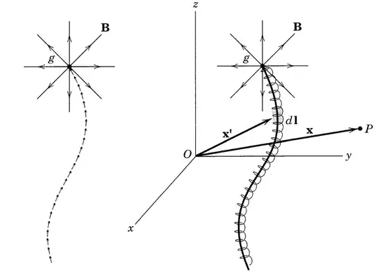

Dirac came up with a solution for a monopole (described in an accessible way here), but it came with it's own "problems": unlike an electric monopole which is only singular at a single point ("$r=0$"), the "magnetic monopole" solution turned turned out to be singular along an infinite line. (It turns out there are two ways to see this, either as a "succession" of dipoles (left), or a tightly wound semi-infinite solenoid (right), both stretching off to infinity, as shown in the figure below. See Jackson's Electrodynamics "6.11 On the Question of Magnetic Monopoles" for more details, and a complete description of the image below.)
A system like this cannot be described by one single vector potential over all space, precisely because it is singular in this fashion. However, it turns out that one can define a vector potential that describes nearly everywhere in space (except along the monopole itself).
