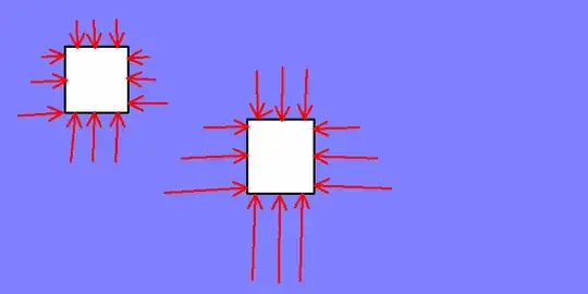

Look at the following picture showing two equal bodies at different depths.
At greater depths the pressure forces (shown as red arrows) increase. But you also need to consider the direction of the forces. The forces everywhere point into the body (perpendicular to the surface of the body).
Therefore, with increasing depth not only the force acting on the bottom side of the body (pointing upwards) grows, but also the force acting on the top side of the body (pointing downwards) grows. That's why these forces partially cancel each other.
In the end the vector sum of all these forces turns out to be independent of depth. It depends only on the volume of the body. The buoyant force is equal to weight of the displaced water. This is Archimedes' principle. See also question "Is there a reason behind why Archimedes principle works?" and its answers.
