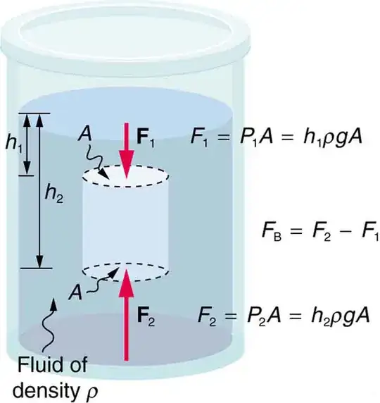

Buoyant force occurs due to the difference in pressure in the liquid.
Consider a cylinder of height h in water
The pressure along its curved side will cancel out because at each height equal pressure is applied from all directions (Pascal's Law).
Therefore only pressure on the flat surfaces contribute to the net force on it
$$F = F_2 - F_1$$ $$F = P_2A - P_1A$$ $$F = (\rho gh_2 - \rho gh_1)A$$ $$F = \rho gA(h_2 - h_1)$$ $$(h_2 - h_1 = h)$$ $$F = \rho gAh$$ $$(V = Ah)$$ $$F = \rho Vg$$ = weight of displaced fluid
Therefore the upward force(buoyant force) on a object in a liquid is equal to the weight of the fluid displaced by it.
