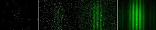

Here are the photons:
dblsphot
Single-photon camera recording of photons from a double slit illuminated by very weak laser light. Left to right: single frame, superposition of 200, 1’000, and 500’000 frames.
Each photon footprint is like a random dot on the screen on the left. The accumulation shows the probability wave nature for finding the photon at an (x,y) of the camera screen.

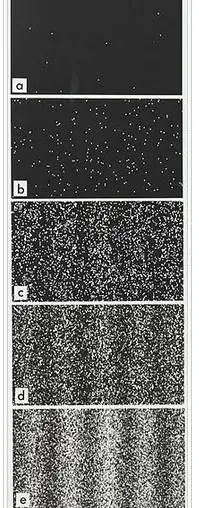

And here are the electrons,
dblslitsingle,ect
Electron buildup over time
The behavior of single particles leaves a particle footprint both for photons and electrons, and a probability interference pattern when the number becomes large.
