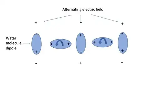

The diagram below is perhaps a crude way of showing how the electric field component of the electromagnetic wave interacts with a water molecule inducing rotation. The water molecules is a an electric dipole owing to the spacial arrangement of the two hydrogen at one end and one oxygen atom at the other. It is overall electrically neutral, but is positive at one end and negative at the other forming a dipole, as shown.
At the electromagnetic wave propagates past the molecule, the electric field component alternates in polarity. When it does the molecule aligns itself (rotates) with the field due to the attraction and repulsion forces. That gives the molecules rotational kinetic energy.
